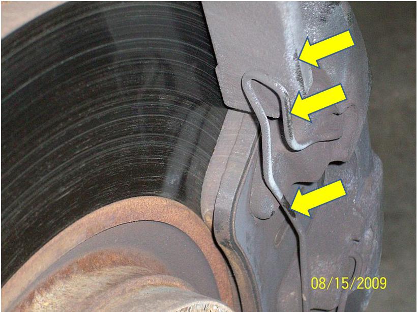

Number2 wrote:brakes look like they have some good life left in them. 36k miles? I'd see about having the rotors machined.

What's this on the passenger side? Just where you bumped it? Pads look fine.

Check the inner pads. Can't tell you how many times I've had the inner pad wear MUCH faster than the outer.
You may also want to clean and lube your caliper slider pins while you're in there. Good preventative maintenance if nothing else.

MazdaTom wrote:Check the inner pads. Can't tell you how many times I've had the inner pad wear MUCH faster than the outer.

AIM WO4 wrote:What's this on the passenger side? Just where you bumped it? Pads look fine.
Yeah, where I brushed off some dust with my arm.
They showed me the inner pads and they are a little more worn than the outers. Those are the ones with 20% left.
