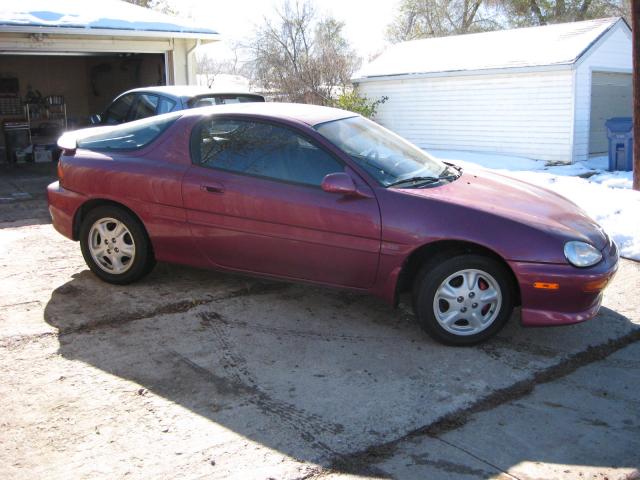

Forgot about the recoat window. I guess our painter always got the parts to paint within a few hours of me working on them. Crap! Ok, assuming you have to do all the masking and spraying, on the attached car, and I guess remove the fenders to spray the top part of them, the doors for the jams, and the hood to get the underside. If you can give me a ballpark estimate that would be cool.

I didnt get a chance to call on the paint today, but just adventuring a guess here, I would go ahead and say between $250-$500 for the paint, the best thing you can do to lower the cost for me to do it is have everything pulled like door handles, mirrors, spoilers, moldings etc and then the headlights, taillights, etc really aren't a big deal. The biggest thing I ask is to have everything you want sprayed prepped and ready, I will go over the whole thing previous to spraying it as well and make sure its ready because two people looking something over is always better.
Let me think about it some more before I give you a final price.
