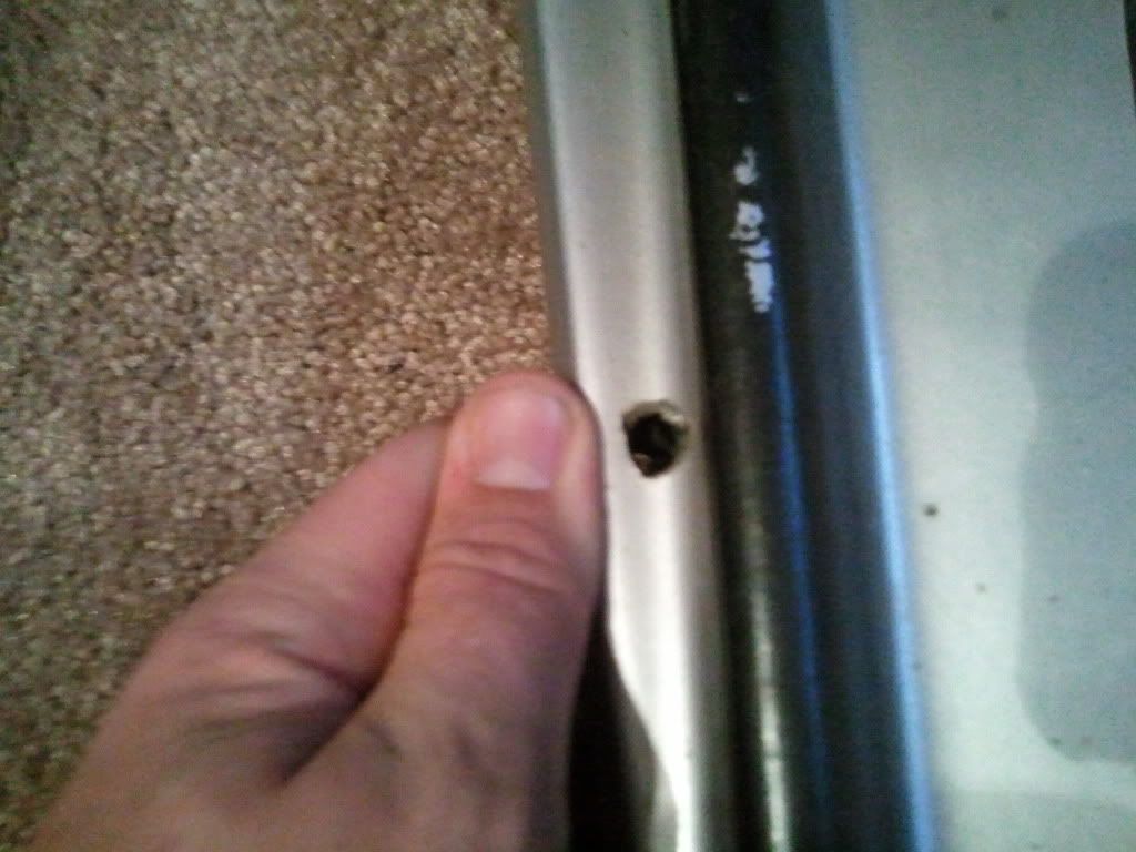

And here is the hole in the side skirt. I put my thumb next to it so you can get a size comparison.
Postby RX-7 Chris » Thu Dec 23, 2010 9:14
it is hard to tell, is it fiberglass?
mog1017
Posts: 152
Joined: Sat Dec 18, 2010 9:14
Postby mog1017 » Thu Dec 23, 2010 9:14
Yeah it is
for the small cracks, you can probably get away with using an epoxy. For the one with the laundry basket, you may want to patch with fiberglass. It also may be good to reinforce all of the cracks with some fiberglass on the back side.
