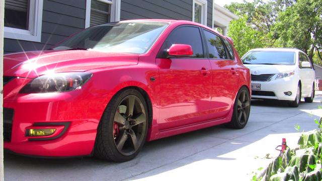

Got the coilovers installed. Now I need to start fine tuning things. The fronts feel great, the backs are quite bouncy the way they are set right now. I definitely like the drop though and the car is so much better planted and responsive.
Postby Shadowden » Mon Aug 27, 2012 9:14
they look great. llooks like you have a really nice ride height. Do you have more dampening you can put in the rears?

Yes. I haven't even touched the dampening on the rears yet. I only set my ride height and the spring height in the back. Right now the ride height is dropped about 1.75". Floor to the top of my fender is 25 1/4". It's definitely a trial and error process.
On a plus side, I found a guy in Lakewood who can align lowered cars. http://www.lakewoodalignmentandbrake.com/about-us.asp
They have their alignment machine over a pit so they can get the car on the rack. $72 for the alignment. Could be a little more if things are way out of whack. After I get done playing with the settings at least I have somewhere nearby that I can take it now.

I ended up needing to raise the ride height a bit. I was rubbing pretty bad and cutting my tires. I have 8" wide tires so I rolled my fenders last night. Seems to have done the trick.
I still need to make some damping adjustments in the rear and get my RSB on. The rear endlinks will not come off so I need to cut them and buy new ones unfortunately.
