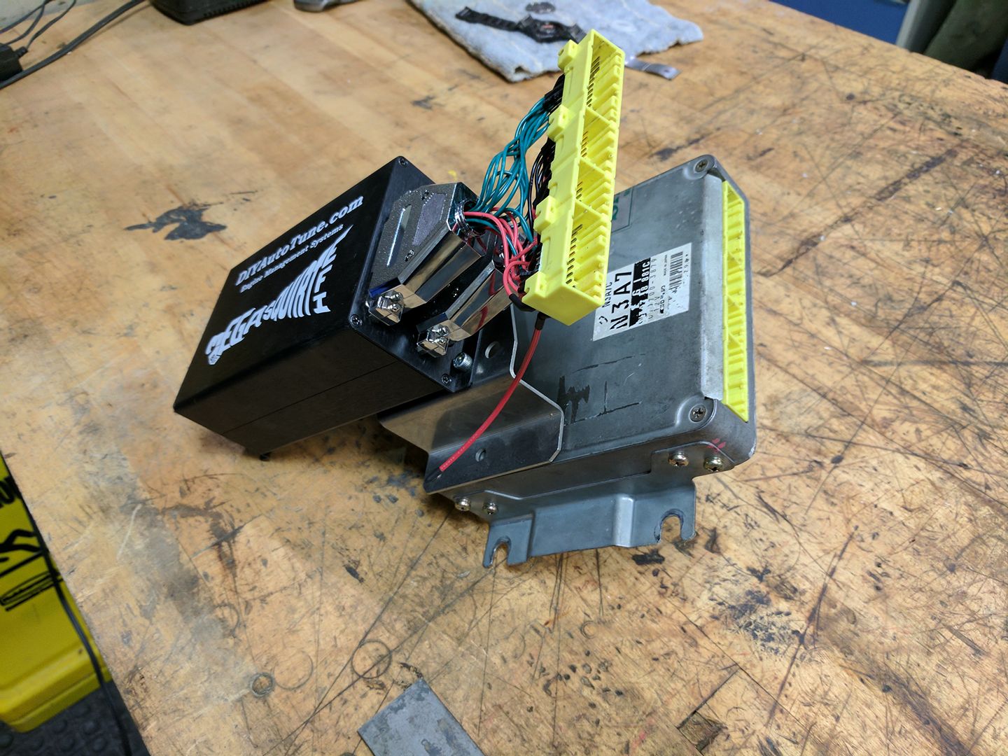

. The following weekend I was able to plug it in and start fussing with it, I was very unprepared for how much tinkering and tweaking it was going to take to get the MS to play well with the factory Mazda VR timing system. This weekend I finally got to playing with it some more and finally achieved a clean stable tach and trigger signal to get going. So now the tuning starts! I set up a very basic tune to get started and will be putting around on that for a few days. Once I get it where I trust it to be in a safe running condition I will start configuring the turbo sequencing system. I have also purchased some parts to build a piggyback OMP controller that will be installed once I have a chance to log some data as to the control parameters of the OEM system operate. The prototype controller will be clunky and big but once it is proven to work I will need to find someone that makes circuit boards. I have DIY them in the past but was never happy with the result. Overall I'm very happy with the choice but wouldn't recommend it to anyone who doesn't want to spend crazy amounts of time perfecting it.MS3X'd FD
MS3X'd FD
About a month and a half ago I ordered a DIY MS3X kit from DIY Autotune. I took apart a spare OEM ECU and unpinned the connector to make a PNP pigtail so that I can continue using the OEM computer until I am satisfied with the tune and operation. The ECU assembly was relatively easy, just a BUNCH of soldering and assembling. Once it was together I am unable to do much during the week due to my living situation
 . The following weekend I was able to plug it in and start fussing with it, I was very unprepared for how much tinkering and tweaking it was going to take to get the MS to play well with the factory Mazda VR timing system. This weekend I finally got to playing with it some more and finally achieved a clean stable tach and trigger signal to get going. So now the tuning starts! I set up a very basic tune to get started and will be putting around on that for a few days. Once I get it where I trust it to be in a safe running condition I will start configuring the turbo sequencing system. I have also purchased some parts to build a piggyback OMP controller that will be installed once I have a chance to log some data as to the control parameters of the OEM system operate. The prototype controller will be clunky and big but once it is proven to work I will need to find someone that makes circuit boards. I have DIY them in the past but was never happy with the result. Overall I'm very happy with the choice but wouldn't recommend it to anyone who doesn't want to spend crazy amounts of time perfecting it.Re: MS3X'd FD

Actually I made a standoff bracket and mounted the MS to the oem ECU. Still haven't done much tuning wise, just making sure everything is set up right and solid.

Nice arrangement.  Standoff bracket bends look nice.  What did you use to make them?
