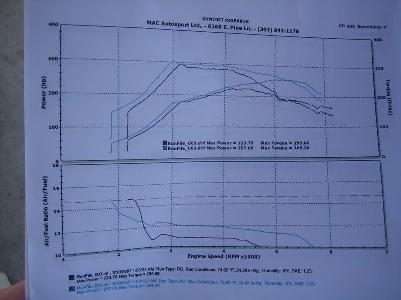

My car (former Speed6) stock didn't taper boost like most Speed6's, if you take a look at a graph on MAC's dyno, with my Speed6 with only a CAI & BPV vs a stock Speed6 on the same day, you can see how much more aggressive my car's stock non-flashed (by choice) ECU tune was. Notice how boost didn't drop off, on my car... just like Rich's car is AFTER the Standback map, hense why his gains were so large... just due to the lack of boost tapering off at higher RPMs. The biggest reason why his gains with a tune were so much larger than they were on my already aggressive factory tune:
Interesting stuff.
