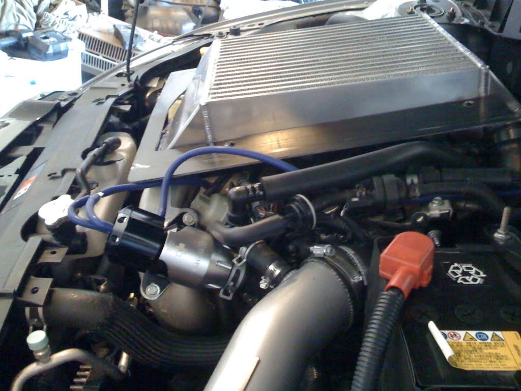

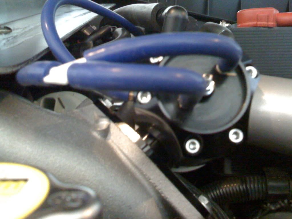

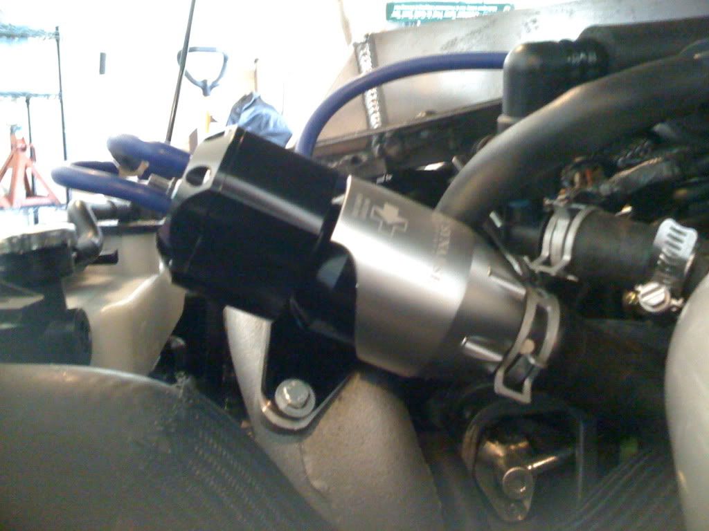

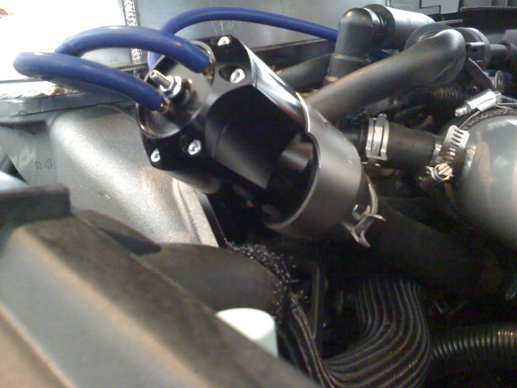

I believe we use the same cold pipe, just put a BOV on a MS3(I'm Batman's)
I took some pics showing my orientation, now you have a SRI, and the filter might be more of an issue for you.:confused:
to get an idea of the angle of mine......
just the big picture and shows how close everything is.

this shows that the BOV is as high as I can get it with out interfering with the valve cover vent to intake tube.
IMG]http://i582.photobucket.com/albums/ss269/glisano1/IMG_0117.jpg[/IMG]
just trying to show that the top of the BOV is almost the same level as the TMIC shroud.

I guess the pics were to big the other two:
Now I have the upgraded engine mounts in my car, front and back. I have a 2-3 inch scar where the BOV rubbed without me knowing. It started acting weird, so I checked and sure enough there had been a hole worn in the top line. Now I am betting I have about 1/4 inch clearance now with the hood closed.
