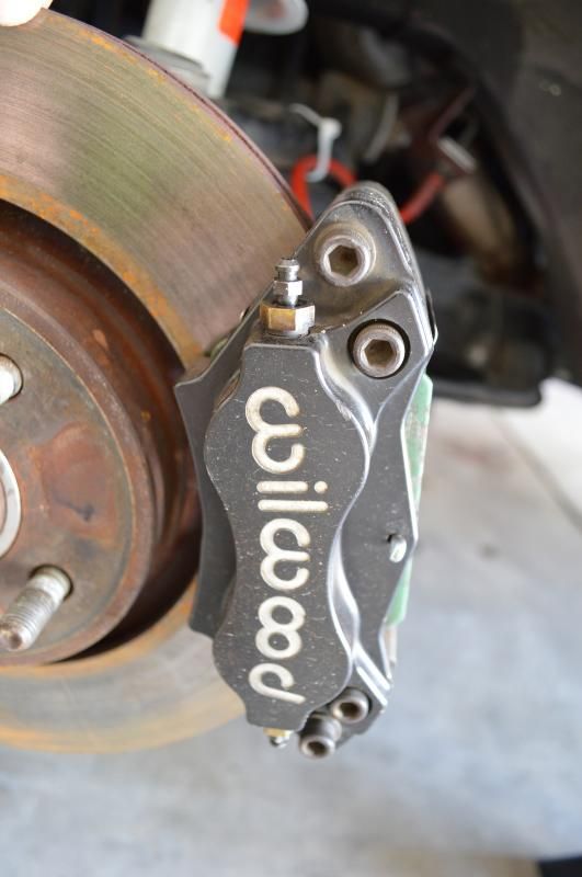

I couldn't remember but did you get SS hoses with that setup?
Postby Huzer » Tue Jul 15, 2014 9:14
RX-7 Chris wrote:I couldn't remember but did you get SS hoses with that setup?
Yep, SS hoses all around. No leaks at the caliper or at the hardline connections. The brakes were mushy before, I figured I didn't do a good job bleeding the first time around when I did pads/rotors. This time, I know I had no bubbles in the lines. I made sure to hit both top bleed screws on the fronts.

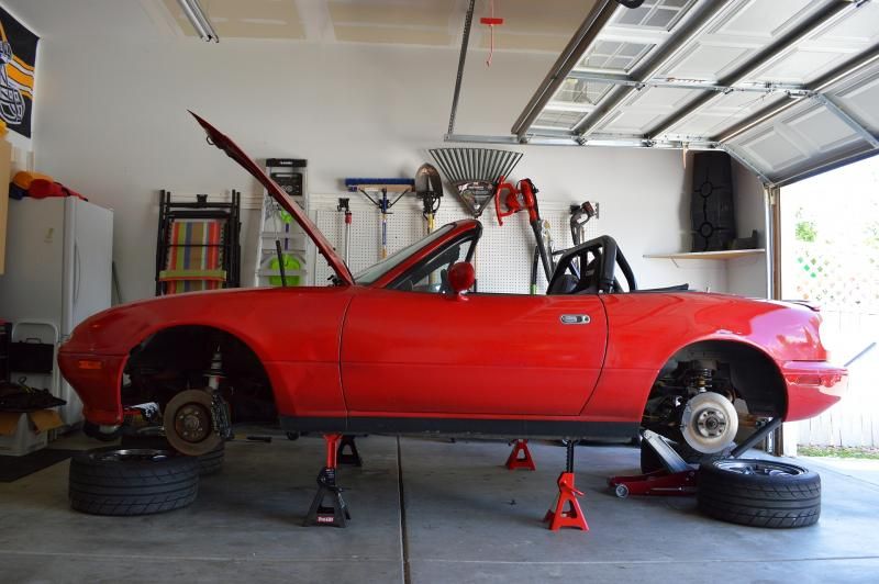

Brake job, part 2. I'll hopefully be done sometime tomorrow, as I'm not in too much of a hurry. Got it up on stands today, but have some plans for later. I'll probably get everything wrapped up tomorrow.

Hmm, I guess I'll need assistance on the brakes. I had my wife help me bleed and no difference. Change the master, bench bled, now it's worse. I guess my level of brake knowledge is replacing pads and rotors. Odd, I've changed lines on the MG, the RX8, and didn't have this much difficulty bleeding and getting the brakes back to normal. To take it to a shop at this point, I'd have to tow it, as the parking brake is the only brake that feels solid.
