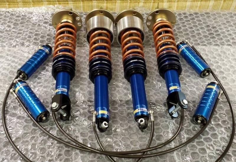

FDEEZ wrote:Are those JRZ Pro's specifically for the FD Rx7? If you're not going to purchase those, would you mind if I grabbed them? Can you PM me your buddy's contact info? My coilovers have less than 1k miles...but I wouldn't mind upgrading.
I'm not going to buy the coilovers. Those are a steal though. I don't know for sure if he'd give you the same price, but he didn't tell me that price was only for me either, so who knows haha.
I actually talked to him about trying the cups on my coils and coilovers, so I'm going to try that when I get back. Then I'd just buy the whole VRH kit from him.
What coilovers do you have now? I'll send the PM after work if I can remember so I can get his number for you. And I'll make sure it's OK with him to give his number out first haha.

FDEEZ wrote:I've got Pettit TrakPro's with 10/8 springs. With the amount of downforce I'm planning on putting on the car, I doubt these will suffice.
Btw, do you know the spring rate on those JRZ's?
Oh OK. No I don't know, but I sent him a message. Now we wait lol.
