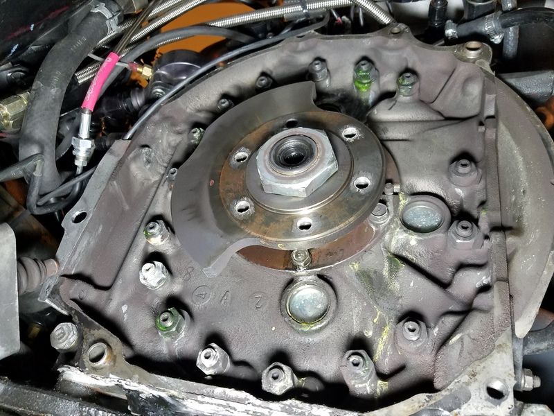

I got the tranny and clutch out this afternoon. The tranny came out super easy, I didn't have to remove the diff brace/cradle or the PPF fully. I'm waiting to hear back from RHDJapan on whether the parts I ordered are correct or if I'm screwed and have to get a whole new clutch. The other mid plate I was thinking I'd need is either the crown or the pressure plate, I'm still trying to figure that out. Either way I don't see it for sale separately on their site.

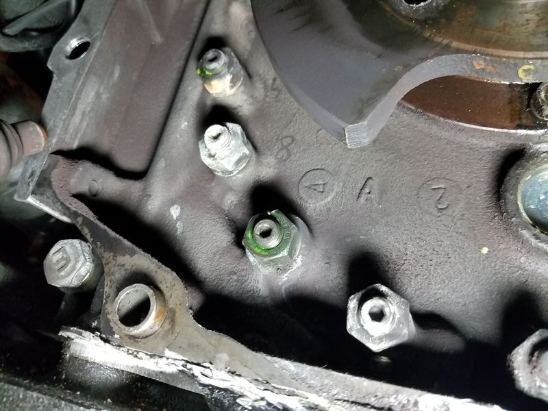

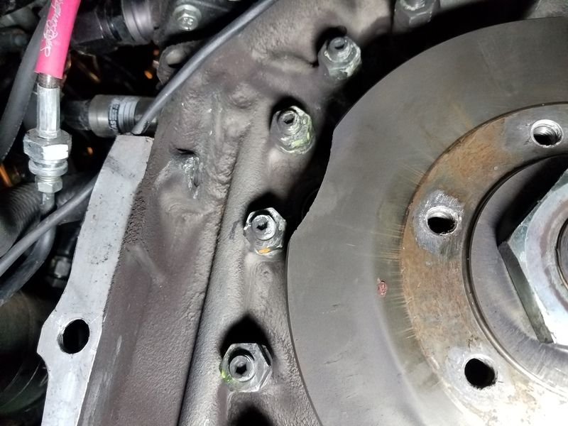

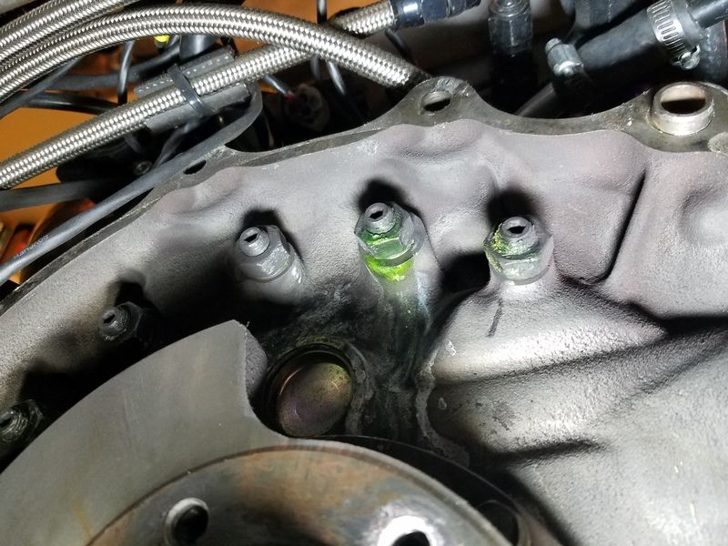

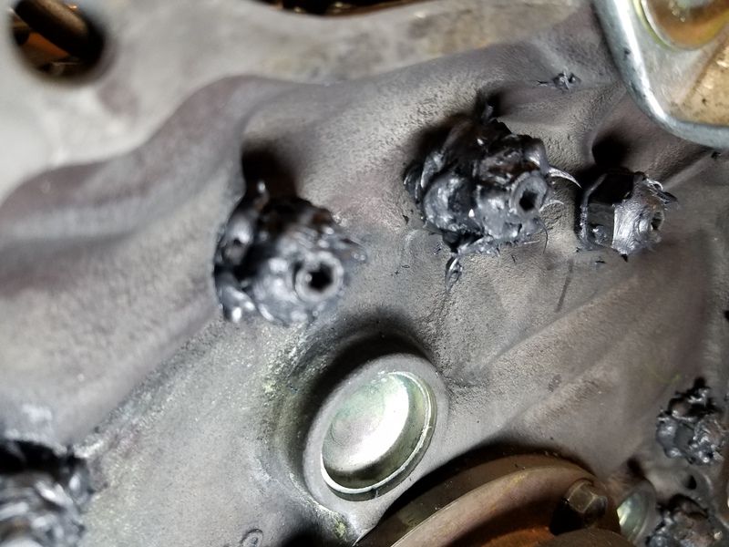

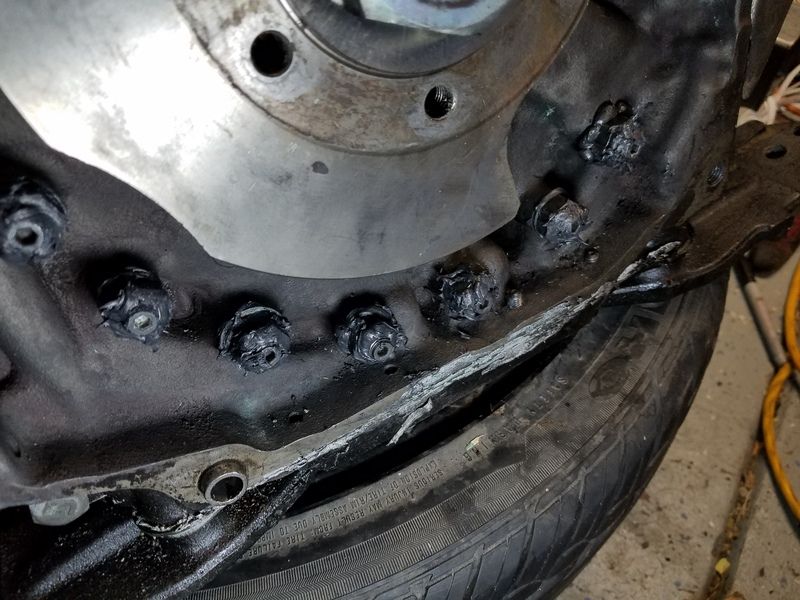

Also, I'm really hoping not but I might have to rebuild the engine again. I've noticed before that there was coolant residue on the bottom edge of the bell housing, and after removing the flywheel I noticed where it's coming from.

Yeah I'm not a fan of this situation either lol. The clutch overhaul kit is about $650 or so, and the mid plate was $145. If I end up having to get a new clutch I might just go back to a single plate. Apparently the twin plates don't hold much torque. I don't know how they compare to a single plate though. They're checking now to see if the parts I ordered are going to work for me. If so I'll take the flywheel to get resurfaced tomorrow.
My buddy I was stationed with in Okinawa told me the coolant issue is a sign of bad water seals, although I'm not sure if that means compression is pushing the coolant out past the studs. The studs go through the coolant jacket so they're going to have coolant on them anyway, but if the inner water seals are bad I guess compression could push it out past the studs. However, if that's the problem then the champagne test should confirm it. Unfortunately I already drained the coolant and oil so I can't do that test unless I refill them and I don't really want to do that until putting the engine back in. But if that's what it takes, maybe I'll do that anyway. Basically, if it's the water seals I'll buy just those and reuse everything else as long as the rest is good. And it won't take long to rebuild that way either. Dave's issue was a stuck apex seal. Mine could be a water seal, so it may have pinched or something when building the engine.

UPDATE: After posting on facebook one of the guys told me that when studs are used you're supposed to put silicone on the threads so coolant doesn't seep out through the threads. That makes perfect sense since the head on the stock bolts hold the coolant in, and I'll be adding either silicone or RTV while the engine is out. That should fix the problem.

Do the studs still use the o-rings like the tension bolts? If not then that would certainly cause a leak like that.

chickenwafer wrote:Do the studs still use the o-rings like the tension bolts? If not then that would certainly cause a leak like that.
Yeah I'm still using those washers but the rubber inner part on them isn't in very good shape as it turns out.

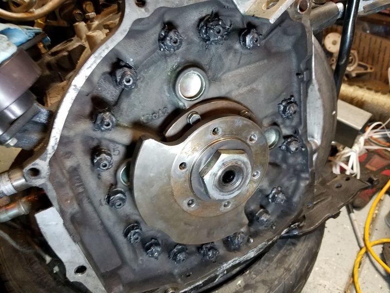

Well it's actually RTV. One of the guys said silicone but I figured he meant RTV because silicone wouldn't actually seal anything.
The other day I started getting the engine ready to pull. I removed the turbo and manifold and discovered that only one of the bolts was really tight. YIKES. The other three were not much more than finger tight. Then I discovered another problem. Turns out one of my trailing spark plug wires was arcing to the engine. So I'll be making a new one I guess.
I got the engine out tonight and got all the tension studs sealed. It took a good hour and a half at least, probably a couple hours. I had some issues with some of them because the RTV wouldn't stick if there was any coolant present, so I gooped the shit out of them after lol. I took the nuts and washers off, applied RTV around the stud where it drops into the engine, then pushed the washer on and used some of the excess to put on the threads, then I torqued the nut back on and used RTV on the end of the nut and exposed threads, and put some more at the base of the nut and washer if it needed it. That better do it lol.

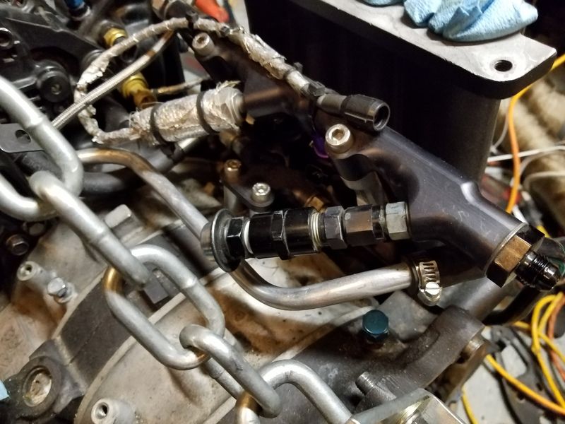

So this getup is what Chris had to do to incorporate a fuel pulsation damper into the system. It takes up a bit of space, but so far I haven't found anything simpler or smaller. Tonight I saw that Radium sells one that is a rising rate damper, but I'm not sure if I can make it work with the available thread pitches they have, not without it being just as bulky as this one.
