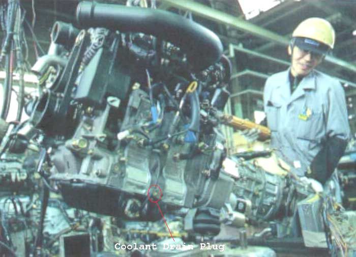

Postby 4g63<13b » Thu Apr 12, 2012 9:14
Hey i finally found a picture that shows it, since i cant take one since im not with my car but, the little tube that runs into the oil pan in the picture, i noticed the one on my car is torn, im not sure what this is?
