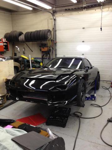

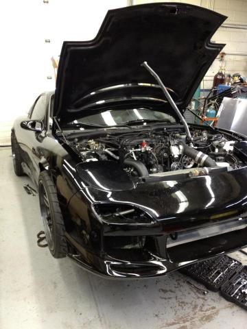

I dropped the car off at the shop tonight. I removed the IC piping (just turbo side), the feed oil line, lifted the strut bar, took the nut off the Vband clamp on the turbo...I think that's it. It was too hot still to do anything else and I wasn't going to wait around for it to cool down when I can just take off the stuff in the morning. So tomorrow, it begins...
Oh, I also stopped by some exhaust shops this afternoon to try to find two 3"-3.5" flares for the downpipe, but to no avail. So I guess I'll see if Tom can make some for me tomorrow. Although, now that I bought the flange to mount to the midpipe side, Tom said he thinks the DP is 3.5" LOL. So I may have to buy a new flange also, along with bigger flares than I thought. We shall see.

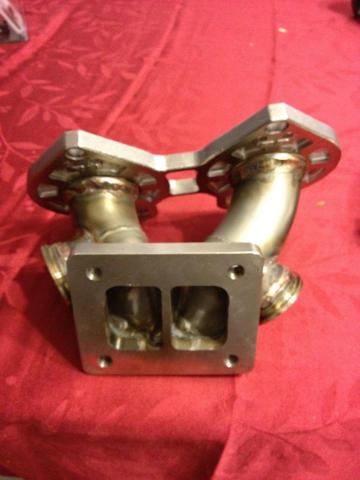

Postby speedjunkie » Mon Feb 27, 2012 9:14

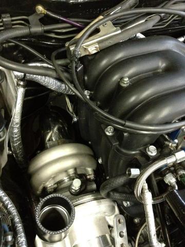

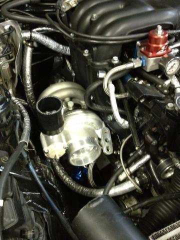

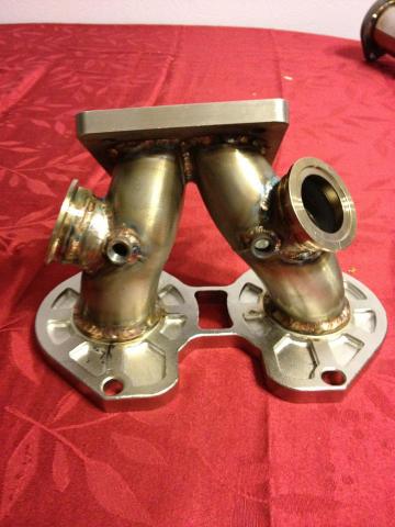

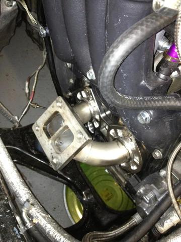

The manifold and downpipe are finished. They are both gorgeous, but now I'm looking at the manifold and the turbo will be tilted 5 degrees forward and the EGT sensors aren't an equal distance from the exhaust flange. I'm a perfectionist and the EGT sensor thing will eat me up but I think I can live with it, they're not too far off. But the 5 degrees thing is really going to bother me, since I worry that it may affect the turbo operation or lifespan. I'm going to contact Full Race and ask them if that's OK. The manual says for the oil drain to point straight down and to not be tilted either way more than 20 degrees, but I think they're talking about the CHRA being turned either way, not whether it's leaning forward or backward. So I have no idea if 5 degrees will be bad enough to try to get a new manifold made. I really like this manifold and the materials, but this is driving me crazy. I'll post pics tomorrow. I'm too tired tonight. Oh yeah, I'm pretty sure I also stripped the lower rear bolt hole on the engine that is used to bolt the manifold onto the engine. Yeah, that really sucks.

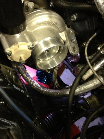

Postby speedjunkie » Wed Feb 29, 2012 9:14
I was going to put the pics up on photobucket but screw it lol. And these are not necessarily in chronological order.

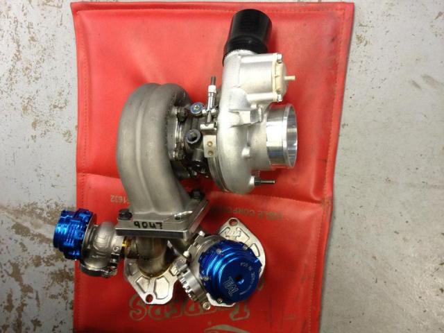

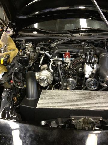

More pics
Postby Shadowden » Wed Feb 29, 2012 9:14
So would you have the tubing (runners?) extended and add more curve to them so the turbo would sit vertically? I'd say if they were custom parts and you rtold them what you needed, that it shouldn't be a problem to have them done to specifications. No point in settling now.
That engine bay is a mystery to me as a whole. Turbos and wires and gauges...oh my.
Well if I wanted the manifold changed I'd have to buy new flanges and all materials and pay to have another one made. And after some research, this mounting orientation won't be a problem, so I'm no longer worried about it.
Haha, the engine bay isn't so daunting once you know what you're looking at. It's probably easiest to break it down into which system...coolant, oil, air, fuel, wiring, vacuum lines, etc. Then if you have a problem you can go from there to troubleshoot. If you have low voltage you're not going to look at the vacuum lines, you'll look at the electrical system, specifically the alternator or battery. That may be obvious to you though, I don't want you to think I'm talking down to you haha.
Of course the main thing that helps is owning the car for several years and always having your hands in it. After all this time, if someone calls and asks me something about this or that, I usually don't need to be looking at the engine bay to know what to tell them. And that's just from experience and constant modification, and most importantly, doing it all myself. And usually when another owner down here asks for help, if they offer me money I'll tell them I won't take it as long as they help me with the work or as long as they do the work and I'm there just for help. That way they learn and can take care of problems if they come up later instead of having to pay someone else to do it. Although there are some that won't stand on their own two feet if their life depended on it, like the kid with the car that was in our back yard for a year and all he needed was an engine harness and we'd have it running for him, FOR FREE. So instead of just getting online and buying a good harness he gets his car back and takes it to a shop where he has to pay for the work done. Uhhhhhhhh, OK? I honestly believe that these cars weed out their owners. If you don't know how to work on them and have no interest in learning, you might as well just save yourself the trouble and buy a Civic or something.
