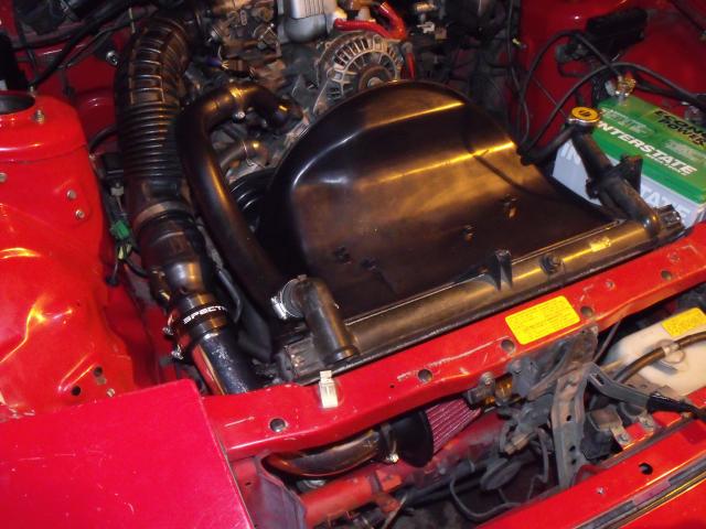

And I'll just leave these pictures here since it's not thread worthy just post worthy. finally got my intake setup how I wanted it. Still needs a little trimming to fit better. And I'll clean it as soon as I have time. The area that was covered by the intake box is too dirty and makes the rest look just as dirty.

nice, yea my intake was a CAI when i was na. didnt make much of a difference LOL

[color="MediumTurquoise"]I completely disagree, The air filter adds 50+hp and has improved my mpg. The butt dyno feels like it added 100hp and it has way more torque. I'm having traction problems now.[/color]
:D Honestly it's more for looks. I'm going to get a e-fan and relocate my battery too. If I didn't need emissions I would strip the engine of all emissions and run a carb.

nice
Postby Bask » Tue Sep 27, 2011 9:14
i like the way that looks.....did u custom make it urself or bought.....i like like:D

Bask wrote:i like the way that looks.....did u custom make it urself or bought.....i like like:D
thanks, and its "custom" I just cut a piece of intercooler pipe that was in a 90 degree shape. I cut a hole just big enough for the pipe to fit in. the metal there is paper thin and I just used sheet metal scissors.
Here is the cleaned up version and better fitment. The intake now sits more tucked in and is getting more "ram" air. The only actual difference between stock airbox using k&n drop in filter and my new setup is that it's not as restrictive at higher rpm. slightly less but less indeed. Also my friend mention that it is longer than before. this is false. the stock air box has a long route just to get to the filter. and it has about a 1" gap to suck in air between the radiator support and hood. I think this has been a very good mod. for being n/a of course.
