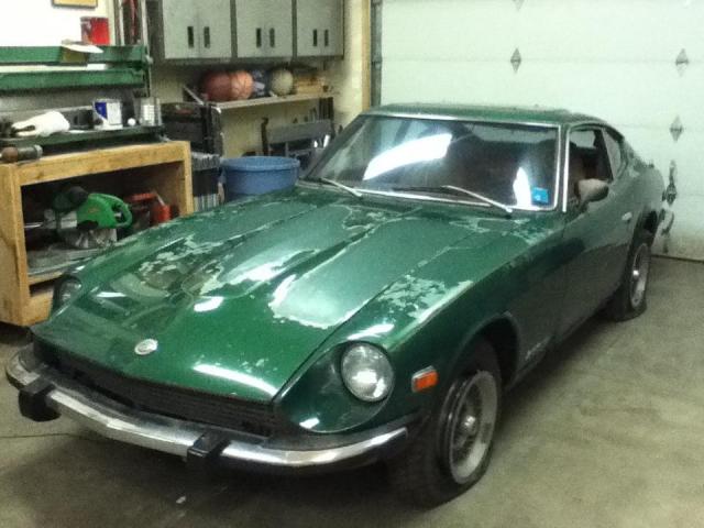

Just picked this up for Lemons/Chump car racing. Got it to start last night running on carb cleaner. Tires need a little air!

Nice!
Postby Shadowden » Fri Oct 19, 2012 9:14
Where is the S supposed to go now?!?
Looks great! That will be a fun car. When you get an idea, you go with it!
