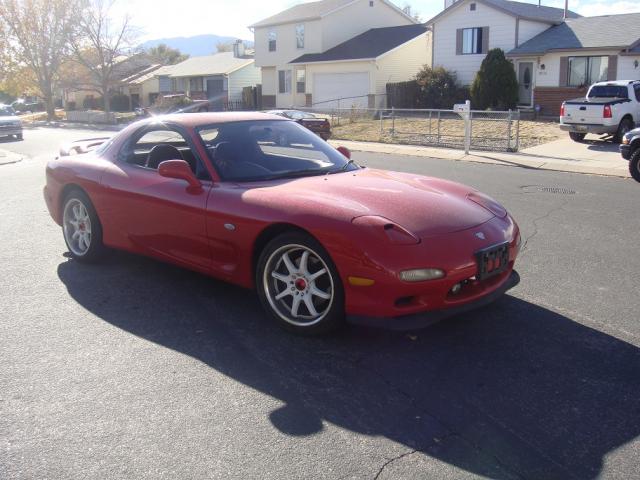

So after just 3 short months I finally have title and tags for the 7!
However due to the cold and sitting some issues have come up on the car.
Firstly most of the instrument cluster has gone wrong. No speedo, No water temp, Odometer appears but doesnt count, Oil pressure unsteady.
The alternator stopped charging and the ABS and CHARGE lights on the dash stay on after start.
I know the ABS is working as I had it activate on some snow.
Can hear a relay in the front left engine compartment cycle several times quickly when key is turned to On.

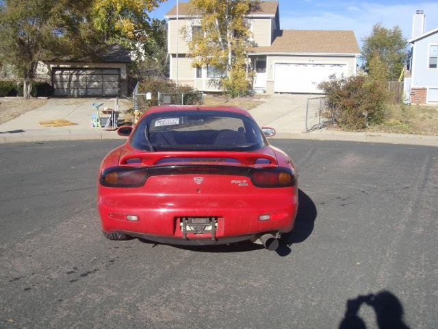

Another thing I found is the Colorado license plates are very different dimensions then the Japanese plate brackets so I will be drilling the tags to match.
