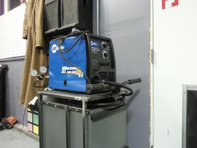

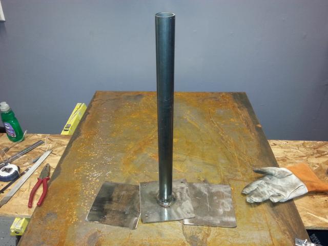

I got interested in learning to weld several years ago, but never took any steps to actually do it. Earlier this year, I made an opportunity to spend time in our welding shop at work and learn from some very talented welders/fabricators. Once I felt like I knew the dangers and techniques involved, I invested in my welder. I picked the Miller Millermatic 211.
Many people make their first project their welding cart. Unfortunately, bringing the new equipment into the garage, I needed to clear up some space. Therefore, my first project was a pair of wheel storage racks modeled after the Auto Dolly version.

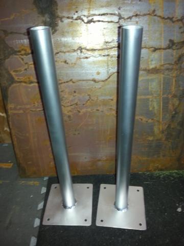

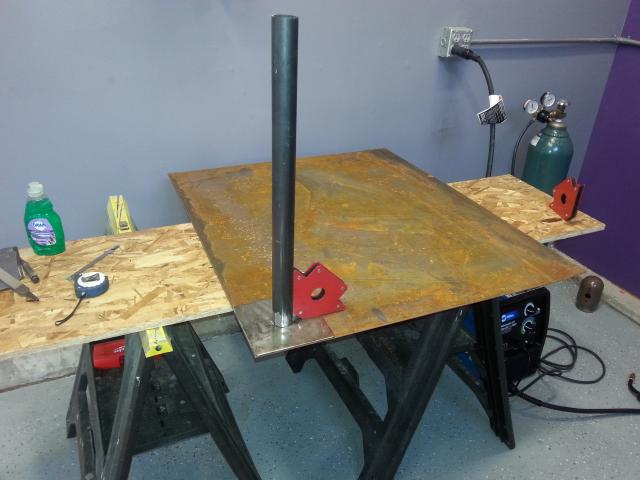

Set up For tack welds
[ATTACH]2765[/ATTACH]
Close up of welds. I worked around the tubing in quarters by going from tack weld to tack weld.

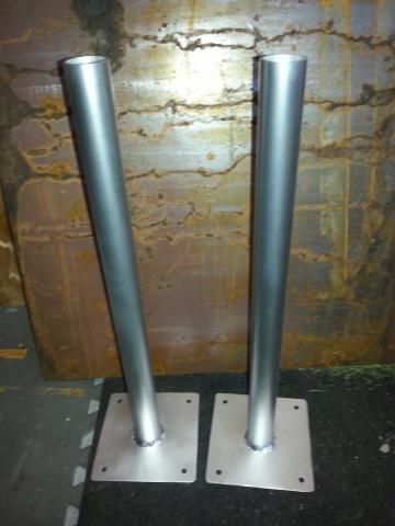

Holder before paint.
[ATTACH]2767[/ATTACH]
Painted.
[ATTACH]2768[/ATTACH]

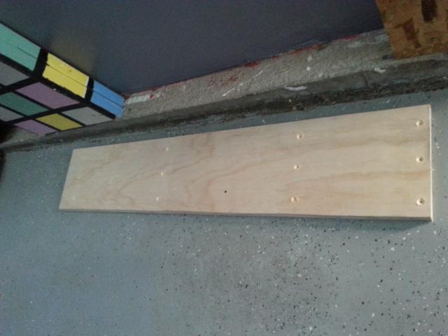

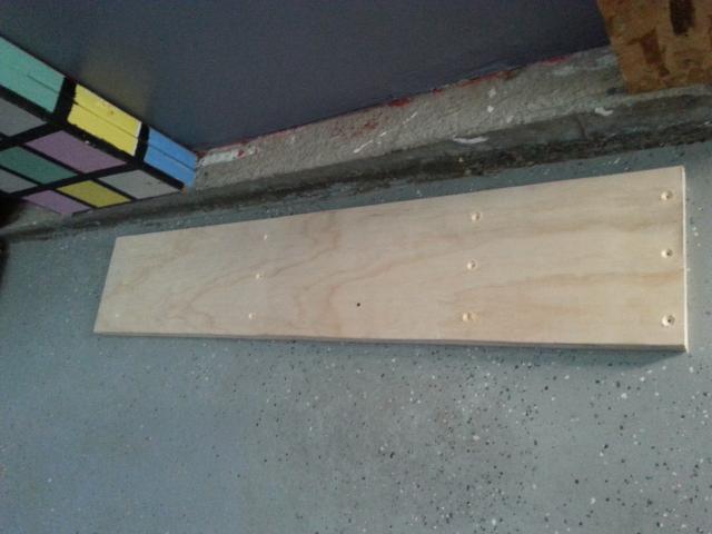

Backer Board. The mounting board is two layers of hardwood ply sandwiched together. The mounting holes were recessed on the back so that the mounting plate would sit flush on the wall. It spans 4 wall studs.
front of the backer board with holes pre-drilled and prepped to anchor to the wall:

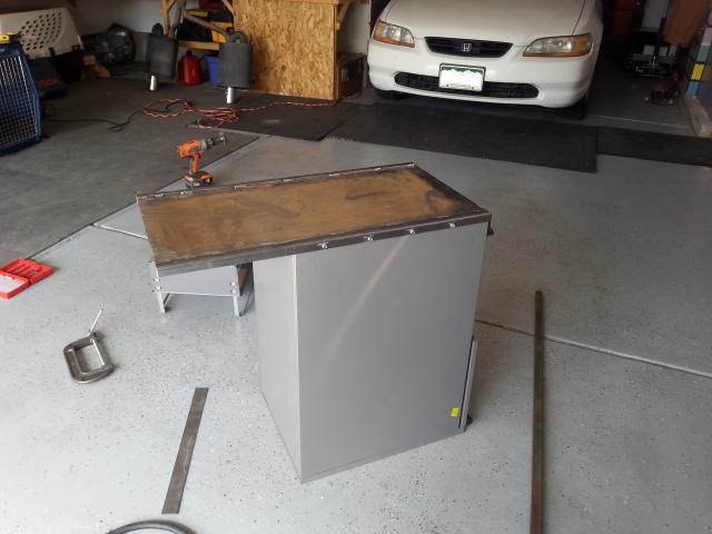

My welding cart has been an involved project. It is structured around a two drawer filing cabinet that I bought off of craigslist for 25.00.
I used 1.5" wide 1/8" steel plate and used the break at work to bend it into 90 degree channel. This was done to eliminate the excess space that webbing on traditional angle iron would have created when affixing it to the file cabinet. 14 gauge steel was used under the cabinet so that the cart would retain shape if/when I remove the cabinet for painting, or in the future if I decide to put a stick welder, tig welder, or plasma device (or something that does all 3) under there instead. The principle function of the cabinet is to hold my helmet, grind shield, gloves, specialized tools/clamps, and consumables.

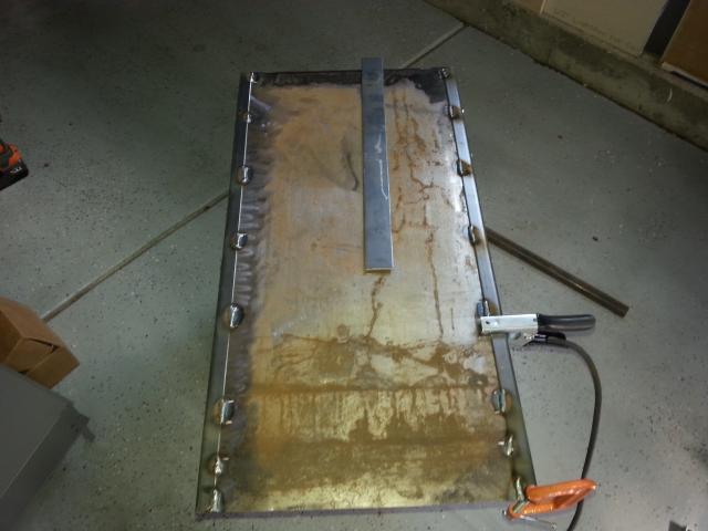

Bottom view showing my stitch weld interval

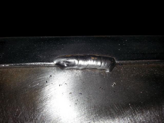

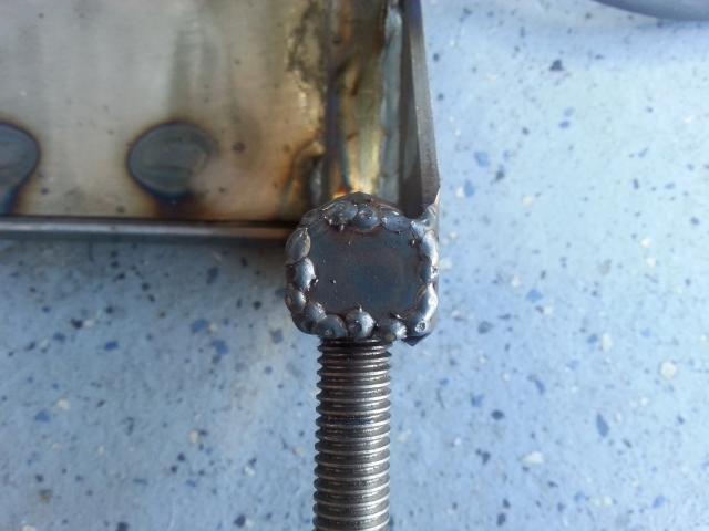

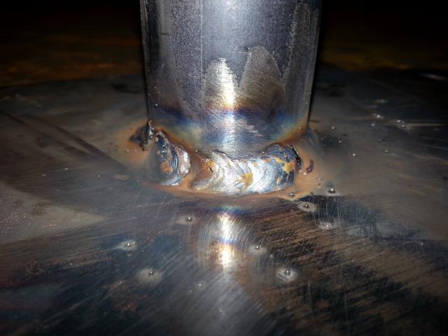

Stitch weld picture. This weld shows a lot of mounding. I am currently welding on a 110v setting. I attribute the excess weld metal to hitting it with too little "heat" and getting the weld too high on the angle iron side. It may be partially due to my slower travel speed as well. The weld is sufficient for its purpose though.

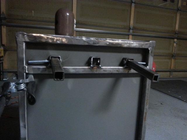

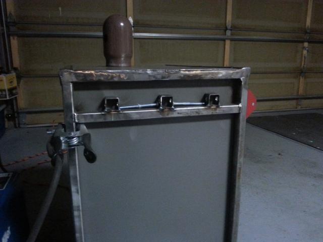

One of the important aspects of a welding cart is being able to move the welder around easily, and transporting the shielding gas bottle with it safely and securely. Shielding gas is an inert gas and isn't flammable. However, if a bottle falls over and the valve breaks off the bottle will turn into a rocket destroying anything in its path.
I designed a method for securing the bottle(s) that is both rigid and capable of converting from a single bottle holder to a dual bottle holder. This is important if I ever decide to weld aluminum, stainless steel, or get a plasma cutter as those methods use different gases.
These are some sleeves welded in place for the bottle retaining brackets to slide into.
[ATTACH]2775[/ATTACH]
Extensions are used so that the bracket is adaptable for bottles of different diameter.
[ATTACH]2776[/ATTACH]

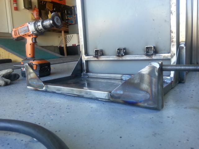

Here is a bracket in the single bottle configuration.
[ATTACH]2777[/ATTACH]

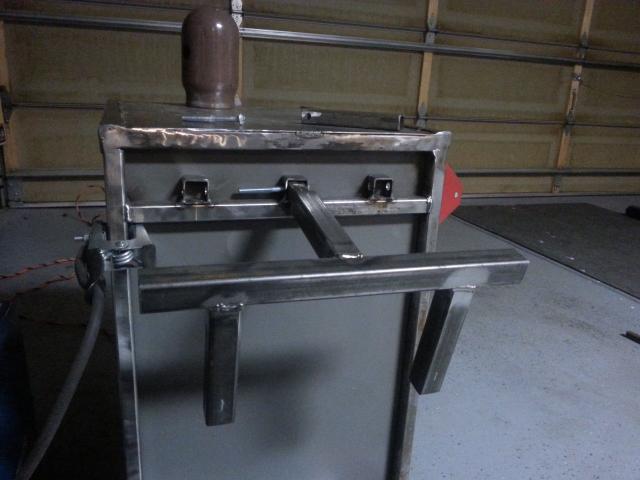

Here is the Bracket in a double bottle configuration.
[ATTACH]2778[/ATTACH]
Bottom bracket in single bottle configuration and wheels mocked up prior to welding.
[ATTACH]2779[/ATTACH]

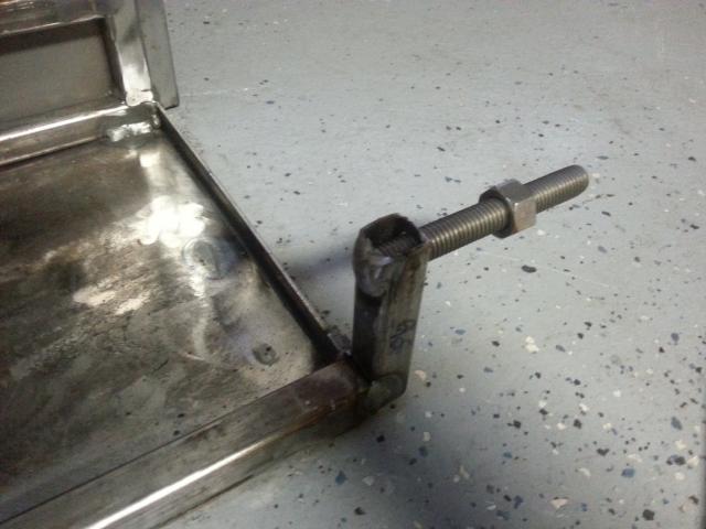

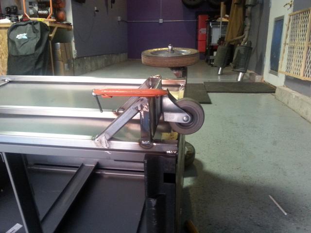

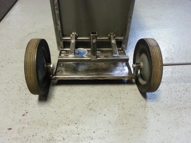

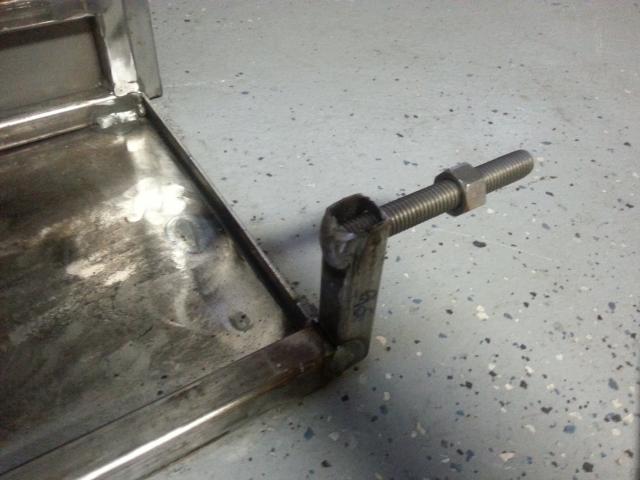

Once the welding cart had some framework in place, it was time to get it rolling. I opted for 10" solid rubber wheels on the bottle side and 3" sealed bearing swivel casters on the welder side. I opted for these to get the easiest rolling cart I felt I needed. Smaller wheels would hang up on more than the bigger wheels. Solid rubber can't be punctured or otherwise go flat. Sealed bearings aren't as likely to get contaminated with grinder dust or slag.
The stainless steel wheel axles welded in place. I cut the axle from stainless all thread. The all thread poked through the hole about 1/4" and I welded it in place on the one side.
[ATTACH]2780[/ATTACH]
Once that was finsished, I capped off the vertical wheel mounts with some thin sheet steel. I used an autobody technique of alernating tack/spot wlds to keep weld heat under control.
[ATTACH]2781[/ATTACH]
I then added 1/8' gussets to keep the vertical posts from flexing inward under load. you can also see some gussets I used to help the bottom angle from deflecting where the cabinet ends and the bottle tray begins.

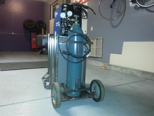

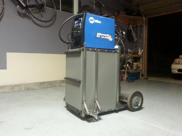

A couple views of the welding court in its rolling state. At this point, I still need to add the actual shelf the welder will rest on, some plate steel to hang angle grinders from, some tabs to wrap cords, and finally the push handle. I also plan to add a 110v outlet strip to power hand tools and a 220V outloet with a long extension chord so that the welder cord is never stretched. The 220 extension chord will likely be 50 ft. I'll make it out of 4 strand 2/0 wire or thereabouts. I plan to use 4 strand in case I can figure out away to tie it to a 110 v outlet when 220 isn't available (like now).
Rolling cart quartering view (no top shelf)
[ATTACH]2784[/ATTACH]
Rolling cart rear view showing a secondary advantage of bottle rack as cable wrap.
[ATTACH]2785[/ATTACH]

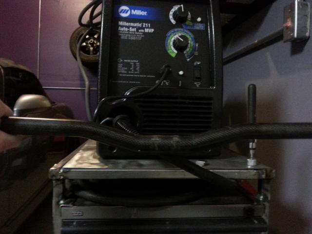

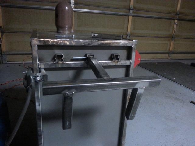

The push handle not yet in place. Thanks to DWDUC's suggestion, I'm going to use a set of mountain bike handlebars as my push handle. They happen to be out of service carbon fiber bars. Will tie in my love for mountain bikes nicely. You can also see I have the top shelf installed. The middle shelf is for storing the welding torch cleanly tucked away. The top shelf is removable facilitating cleaning of the torch storage area. The power strips will be housed on the sides between the upper shelf and top of filing cabinet. In the future, I may add the ability to have the top shelf tilt slightly skyward, but for now, the height of the welder makes adjusting the settings easy while working.
[ATTACH]2786[/ATTACH]

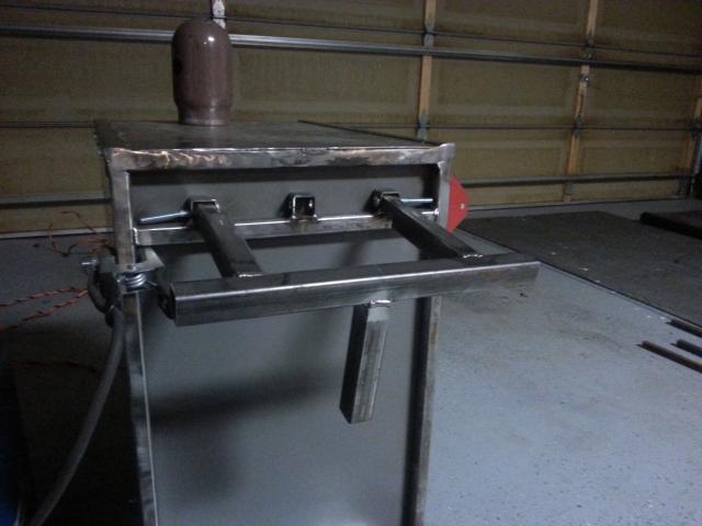

I mounted the push handle roughly last night. There are still some tweaks to be done. I decided to make the handle removable. Therefore, I welded some 1" square tubing to some 1/8" sheet. The sheet is fastened to the cart using 1/4" bolts (nuts tack welded to the cart frame). Tweaks to finish are: weld second nut to back of cart for mounting, close up front of 1" tubing with plate, tap second hole in bottom of Handlebar riser to eliminate spinning (it doesn't spin now, but I haven't tried real hard either).

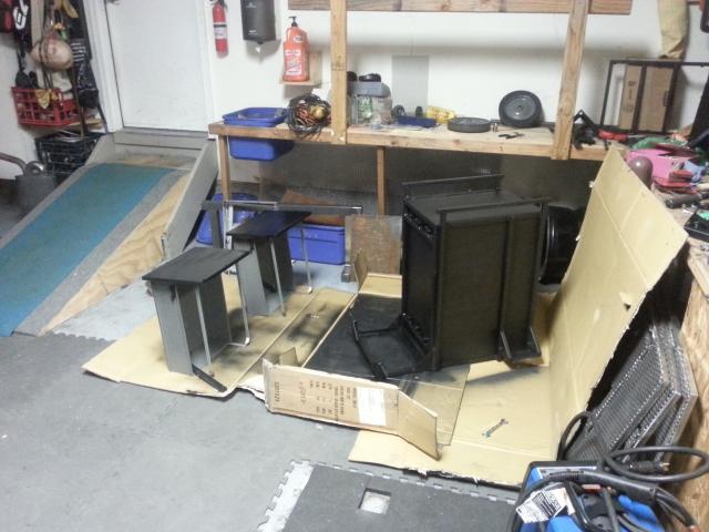

Shadowden wrote:More pictures/info on welding cart.

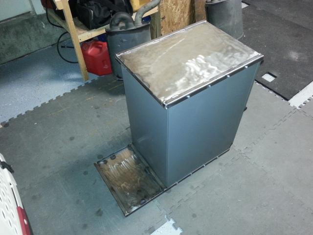

I disassembled the various pars of the cart that I could. Originally, the file cabinet was to be removable, but apparently I got some of the welds hot enough to get the cabinet stuck in there. I didn't really want to destroy it trying to get it out since there would rarely be a need to do so. Because of that, It simplified the paint scheme. Originally, it was going to be a black frame with silver file cabinet, then Sharpie marker some murals on the silver in black. Now the whole thing is going to be black and I'm going to hand draw some murals in white, silver, and gold sharpie marker. I've got an artistic mind, but lack the skill to transfer it generally. I'm hoping the final product comes out nicely though. At a minimum, I think it will be unique. I think I might reserve some space on the cabinet to have visitors to the garage sign it and sketch on it in the hopes that over time it becomes a journal of time spent with friends. We'll see how that goes as I don't want people to feel obligated to do so.
Disassembled and 3/4 painted in its base color. The top will be getting a coat or three of black plastidip.
