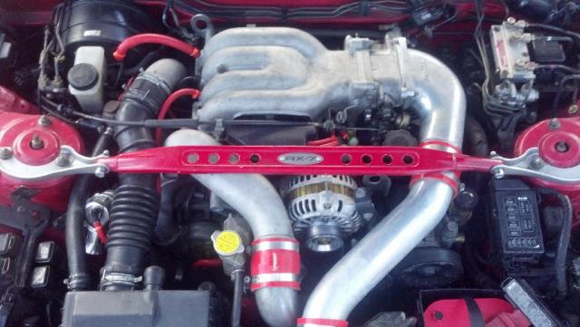

Postby Dwduc » Tue Mar 11, 2014 9:14
engine bay. Now clean and roomy!
[ATTACH]2690[/ATTACH]
[ATTACH]2691[/ATTACH]

Postby Shadowden » Fri Aug 22, 2014 9:14
Dwduc wrote:engine bay. Now clean and roomy!
Nice engine bay!
D Walker
Posts: 437
Joined: Mon Mar 14, 2011 9:14
Postby D Walker » Sat Aug 23, 2014 9:14
Your brake mater cyl is on the wrong... oh rightttttt
