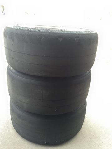

Welp after a year the NT01s finally bit the dust after the last event. I had a set of BFG Sport comp2s lying around and threw them on to the wheels after getting the nittos removed.
The BFGs are 195/55/15 on an 8in wheel. Knowing that not all 195s are created the same I went onto TRs site and confirmed the section width of these tires which were 7.7in wide. They fit perfectly on the wheels and now i'm getting the full potential of the tires. They aren't as grippy as the nittos but they will be my new daily's.
All future race rubber will go on 15x9s.

Although these aren't the greatest tires, the response and handling is so much better on the 8in wheels compared to when I had these tires on the stock 6in wheels. Everything is more predictable and smooth.
