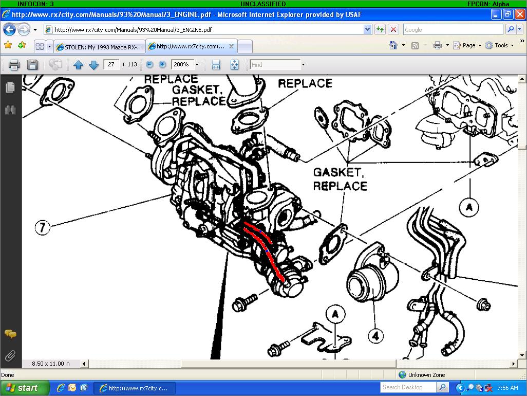

I'm trying to think of where you're talking about, like which stud broke off. It depends on where that is. If it's one of the exhaust studs, it probably wouldn't be too bad if all the other studs are tightened down, but you'd hear an exhaust leak and shouldn't really lose too much boost, if any. Actually it might be one of your restrictor pills too. There are two hoses...screw that, I posted the pic haha. The two red hoses, there should be a pill in each one to restrict the air going to the actuators. If those morons replaced those hoses and didn't know about the pills (just like I did a few years ago when I did my vacuum lines haha), that could be a problem. If you're getting proper boost on the primary turbo though, that would mean they only replaced one of the hoses. The pills are usually in the middle of the hoses, where I put the blue dots. I did hear recently that some models had the pills/restriction built into the actuators themselves, but I'm not sure how true that is. If those hoses don't have pills, don't fret. You can use Holley jets, I think sizes .59 and .64, but I'll have to check again. Actually I still have those hoses with those jets on my twins I think, so I could just grab them off mine if you need them. Check that out and let me know.

You can reach those hoses with it all together. You couldn't if your engine bay was stock like Obie's, but you can with yours the way it is now. Just look down at the two actuators, they're right there at the bottom left of the primary turbo (if you're standing in front of the car looking at it). Just squeeze the hose in different places until you feel the bump in there. If you don't feel a bump anywhere, you either don't have any in there or maybe it's true that they affixed them to the actuators.

Yeah I'm pretty sure you're gonna have to pick it up, haha. I found those hoses last night too. Turns out I had taken them off the turbos, but I found them in my vacuum line bag last night when Zico and I were helping Corey with his. Did you check those hoses yet?
